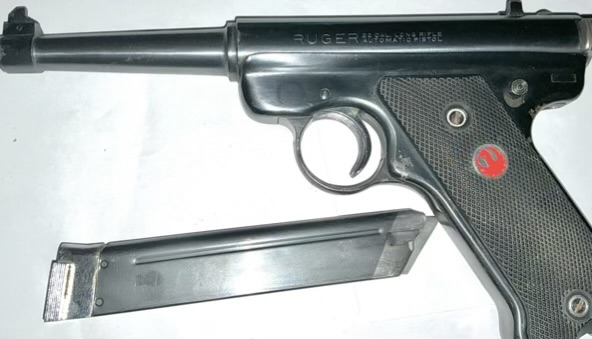

As I researched the early standard Autos in Mr. Dougans Vintage Ruger book I came across an interesting paragraph on page 50. Apparently this gun which is number 2127 (you can also see that number on the side of the COD box picture attachment) was a replacement for the first returned Ruger, as per Mr. Dougan. The original owner has a letter from Ruger saying his order will ship shortly after 9/1/1949. The original owner wrote October 28,1949 on the envelope. What I’m wondering is it possible that the gun he recieved in late October may have been 144, as you mention on page 50 and this gun (2127) is the replacement gun shipped in January?

Thanks John, appreciate the input. So, do you believe, 2127 which is my gun pictured, is the replacement gun for 144 as you stated in your book? If that’s the case then my 2127 would have shipped in January…. correct? The original envelope has October and Nov. dates on it …… wondering if the envelope may have been in reference to the owner possibly have 144 and he returned it (broken) and Ruger then sent him 2127?
Thanks Kenny
