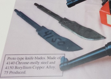

John, here is a picture from one of the calendars I did years ago. I can try and get some better photos. The upper knife has the number stamped on the handle end.
- 20200118_183135.jpg (27.99 KiB) Viewed 13188 times

John, I remember somebody in the past telling me they were directly involved with the project, but don't remember who that was.
I'm pretty sure though it was Jim Hoobler who authored a fine article on the blades in one of the past RCA Journals.
